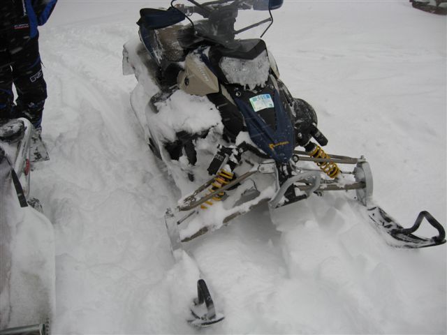

Hey guys,
I am getting an Er-1 code once in a while. I will be going down the trail and out of no where it will feel like I let off the gas and hammer it again and off the gas like it is having a hard time getting fuel/ bad fuel/air. I thought maybe some bad gas as I have only been out a few times. But then my sled died and I have the Er-1. I waited a bit and then it fired up and just had very little power and made my way home. It stalled and gave a Er-1 again a few times.
The display would shut itself off and back on an the fuel pump would prime itself again on its own and eventually start and I kept going.
I know what Er-1 means but I have not looked into it yet but I am looking for some tips to get me back on the snow ASAP (best start to the season I have ever had!).
I have a hunch (hope) that I know what the problem could be. Yesterday I was out on the trails trying to get the trails packed down a bit helping the club. I was often buried in snow and snow was packed everywhere in the sled. I mean everywhere.
I will be taking connections apart at the ECU and clean them up and hopefully my problem will go away peacefully.
On a more positive note, I feel invincible with that freeride track. I can go though stuff I never would have imagined compared to the stock track.
