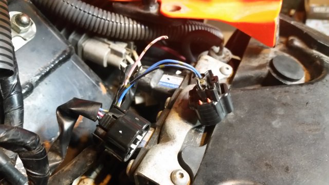

Hey Guys,
I was working on my 09 Phazer RTX today changing the oil and when I fired it up it was idling rough and I was getting the flashing engine light / flashing exclamation mark. After doing some reading on here I checked the senors on the top of the air box and sure enough I found two broken wires (well one broken and one barely hanging on) on the left side sensor. I read that other guys "jumped" the wires but I'm not sure which two to jump. I just want to see if that will take care of the codes or at lease one of them. I'll cut and re-pin the connections later this week. Tomorrow I'll go back out and do some more investigating, had to throw in the towel tonight. Thanks in advance for any advice. I attached a picture of the sensor.

Ouch! I think the only wires anyone jumped were the airtemp sensor which is the other one on box. You are going to need to fix those. Dont chance jumping them. May hurt the ECU.
