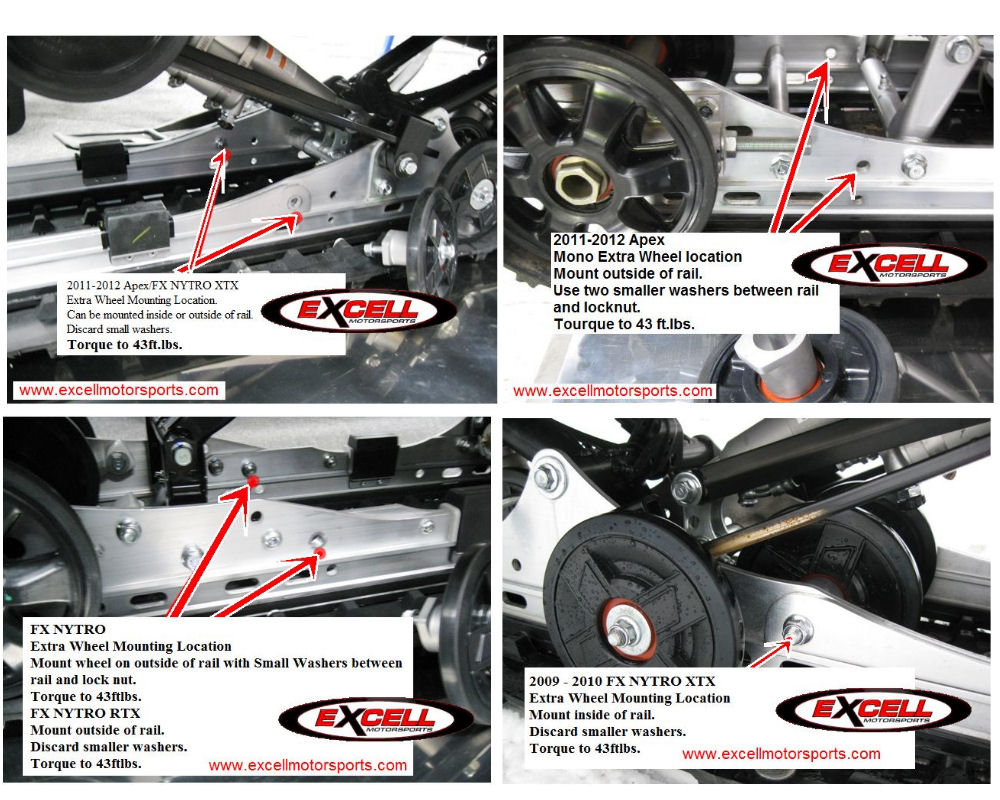

I'm trying to figure out were the two extra wheels mount on a 2011 nytro rtx? Anyone have any pics ? Or any info ?

Thanks for the info and pics
