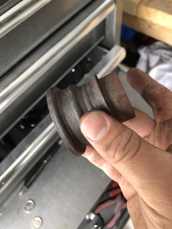

Ended up getting a set off kijiji. As I was taking the the exhaust apart, I notice this was loose from the flex pipe. I didn’t see any cracked welds, so I’m not sure if this piece is pressed on the flex pipe or welded? This is the end piece the exhaust donut sits on. Thinking of putting some exhaust sealer on and pressing it back on if it’s not welded in place.

That was definitely welded from the factory.
Do yourself a favour and order up the flex pipes from fx garage works.

I have welded that part back on before, but a used or new one would be better. Use 6 point socket to remove flange bolts from head.
