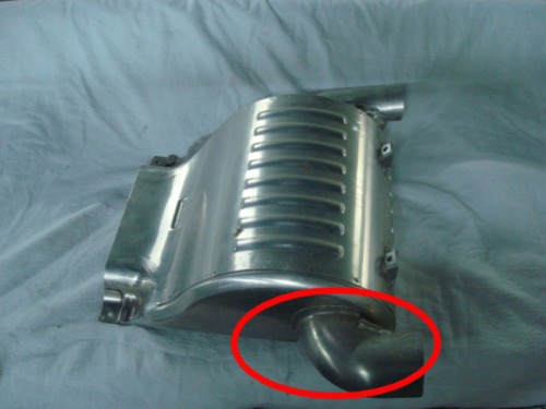

It could be the heat shield under the back of the seat. My 06 did this, there are to welds there that cracked.

Good point with the exhaust cover tabs. I had both front corner mounting points busted off mine when I checked it preseason. ALong with the rear tabs that the seat mounts to were also cracked. A little JB Weld fix and it has been good to go....so far. I could see that causing some rattling and easy enough to check.

I also had the rear bolts that holds the heat shield in place go missing. I noticed a rattle and checked it out. Good luck.

Yep I took it apart and lost like 3 bolts between the exhaust guard and side covers for the tail pipes. DOH. Replaced all the bolts with locktite and good to go!
