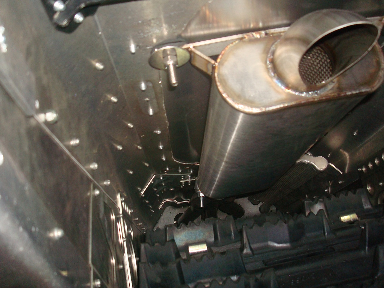

There are loads of streetbike silencers that will fit the standard header as well as the Excell header. You can find OEM silencers and you can find aftermarket silencers. You can find silencers that will be a direct fit and you can also find silencers that will require an adaptor sleeve or a custom built midpipe, depending on inlet diameter, inlet location and where you want the exit.
Personally, I am no big fan of Yoshimura's general build quality, but each to his own. The main point is that you can make most streetbike silencers work.
Attached is a picture of a modified Akrapovic silencer (their 2006-2007 CBR1000RR silencer). This one comes with a short midpipe that was shortened and re-angled to fit the standard header.
Attached is also a picture of a custom built Leo Vince silencer (basically a mirror part of their 2008-2011 CBR1000RR silencer). This one fits the standard header with no need for a separate midpipe.

Without the dB killer inserts, they are pretty similar. If anything, the Leo Vince is just a little bit louder, probably because it is little bit smaller. Please note that both of them are Superbike legal which means they are not very loud with today's rules. For instance, the Ultra Q and the Super Q silencers are noticeably louder.ruffryder said:Alatalo,
How does the Akro sound vs. the Leo Vance?
I never tried the Akrapovic silencer with the dB killer insert, but I did ride the Leo Vince quite a lot with the dB killer insert. The difference compared to riding without the insert is clearly noticeable. No louder than the OEM silencer during low- and midrange riding, just more of a rumble at idle and a little bit sharper at the very top rpm.
The reasons for going for one of these silencers are weight reduction and build quality. The Leo Vince unit is less than 1.5 kg (3.3 lbs) with all brackets included and the build quailty is nothing short of amazing (you can easy spend a night just looking at the welds...).
