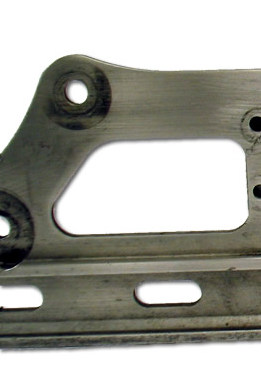

Being toying with doing this the last couple of seasons, but I'd like to get some input from people who have done it. Specifically in regards to increased speed. I am happy enough with skid after re valving to a multi stack in both shocks and re springing the front shock to a Hygear dual rate spring. Guys on here talk about the speed of the warriors and I don't see that the skids are much different except the length. Looking at 128 or 136, very happy with my sled's trail manners just want more going across the lake. Not ready to change skid right now, even though that is what the majority do, as I said, I am happy with the ride. Track is showing signs that this may be its last season, so I thought I'd get some input. Also wondering about the fatigue on the rails at the back arm location, seen pictures of cracks there, I think extensions would add extra stress there, anybody seen this happen?

I have a set of custom made billet aluminum solid 136" rails for the CK skid. They were made by muffin works.
