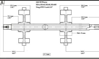

I found these 2 picture with measurements are these 100% correct for 2006 apex GT?
Works ok with 15" wide track but now i use 16" wide track and i have to move both driver ~ 4mm to left to get track middle of tunnel
