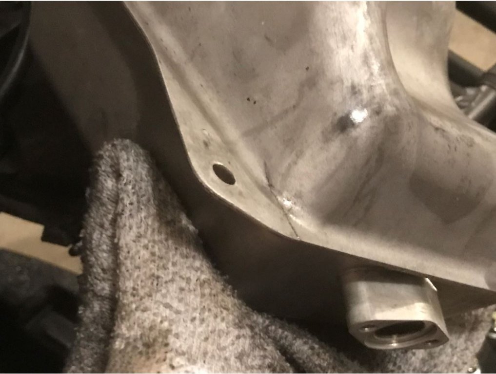

As for the oil leak, I will venture to say it's your oil tank. I had to replace the one on my 08 and the crack was very hard to see. Here's some pics of mine but keep in mind this was after cleaning up the area where the crack was to prep for the repair.

They seem to crack in the area of the bottom mounting bolt. The tank is secured by two bolts at the top of the tank and then one bolt at the bottom right side of the tank. That's where this one was at.
Here's a pic of my tank before I cleaned the area with the crack.

x2 on the oil tank leak. i have not had one leak yet between all the yamaha 4 strokes i have owned but i am due as the 2011 is at 20000 mi mark and has not cracked yet.
