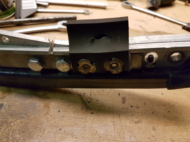

So i took a gamble and bought a used EZ Ryde suspension. It was cheap so I didn’t have it much faith in it. However it was worse than I thought. The previous is apparently a dork.
There is so many errors on the suspension it is almost ready for the bin.
So does anyone has a EZ Ryde 144” suspension that can help me with info and measurements?
- The mounting plates is homemade and don’t fit
- The swing arm is broken
- The rails is broken in 4 places (2 on each side), this I knew
- Not one bolt is the same as on other. Metric and imperial, torx and allen…..
Because of the above I ‘don’t even know if it is a Nytro suspension at all.

Yupp thats correct. I bought it from "blocket". I knew the rails was cracked (which I also stated in the my first post).
It was a gamble and it was cheap so i knew that it probably would need some TLC....
I now have good contact with the previous owner and he had bought it on a sled, so he was not aware of the problems. So i have no hard feeling against him. He took it of and sold it cheap.
What i don't like about it, (very common in DIY community) is the mixture of bolts and nuts. Some are metric and some are imperial. Some are hex and some are allen and some are torx. There are even nuts from wooden furniture on it. I don't think it is EZ Ryde put it there. It must be some crazy swede who didn't bother to get the real stuff and used what he had laying aorund.
I have worked out a plan to repair the swing arm.
Now I just want to know what i have bought and see if i can use it.

Is your plan to weld the rails or buy new ones or what? Do you have any licensed welder that will help you?

I haven't decided yet. First I need to repair the swing arm. After that I will focus on the rails.

Manage to fix the swing arm. I had to build a jig and remove the whole bottom linkage and flanges. But i Think i got it straight and strong.
However, now i have problem with track ratching. It't not all the time, it's just under heavy load. i have the track as tight as i dare to go.
I'm thinking of buying Avids, but the stock drivers are extroverts aswell.
Are Avids better than the stock ones in terms of preventing ratching?
