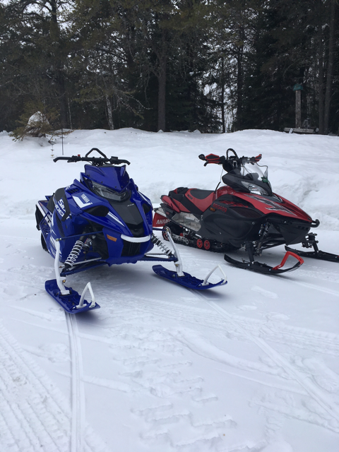

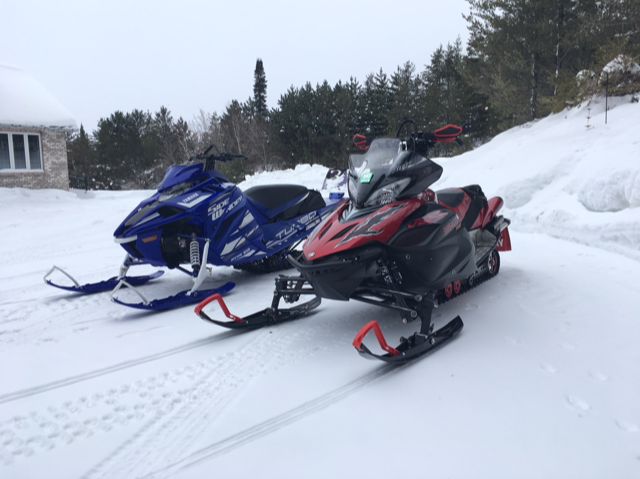

After seeing the 2020 release I quickly grabbed the last new X-TX LE Sidewinder still available anywhere[according to Yamahas dealer inventory information]. I had lost one other one because I dragged my feet too long and was holding my breath that this one would still be available after the 2020s were released. My Apex is not going anywhere either.
Parts are already on order for the X-TX...and so it begins...again.

View attachment 147182 View attachment 147183 View attachment 147184
Congrats on the new ride. Can't wait to follow along on this build!
