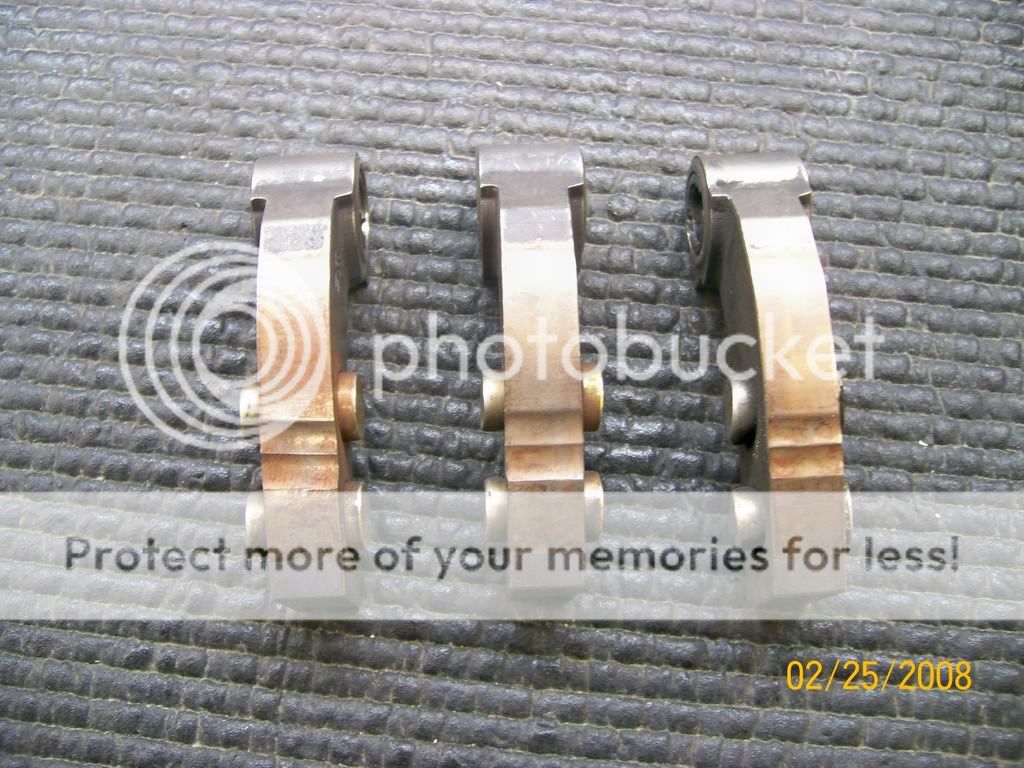

Here are my clutch weights after 6,700 miles. Harmonics at 6,000 and 7,000 rpms repsectively. (My Canada cruise control habit)

We have been blaming the vibration at the PTO level on the motor itself but this could well be the soft coupling between the crank & PTO shaft. I looked at the part # and its at rev 02 already, still the 08er are still reporting positive.
Track howl will be reduced a bit IMO, as the 09 tunnel has way less volume inside, a contributing factor.... but all the rest still is. With a new 09 demo with brand new hyfax, it will pass throught it. Things like 1" track with "quiet track" relief would have shown a desire for improovment.
