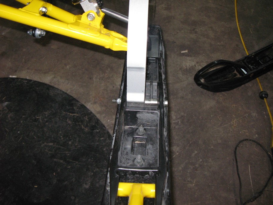

All I did was put both bushings on the outside of the spindle and left the rubber cusion as is. I already had a 3/8 brass shim (Bergrstom copy) under rthe back of the rubber to reduce darting but so far Im liking it....Mr. Pump Gas said:Unchained,
What did you do the rubber boot switch or the bushing or both?
Never mind the filth from the ski mod grinding but here's a pic from last week before I left......
I will check out the rubber boot switcheroo this week and see how that compares to th 3/8 brass shim under the back of the boot right now....
