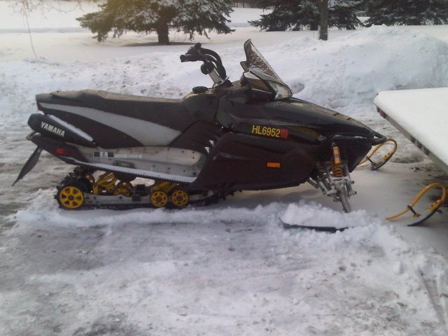

Nope, already had the plastic cut for the apex seat. Straight up bolt on. The seat actually came with rivets but I was changing so much that I wanted it to be easy on/off.
The exhaust was built by me by cutting and welding up what I wanted. I had the pipe bent at 20 degrees and flared to 2.25 on the other end. I then oval-shaped it with my vice until it fit nice on my y pipe that I cut from my stock exhaust. I used some ideas from the katchess thread to make it easier. The muffler is a super trap that I already had. I just welded and clamped or built mounts where needed.
Feel free to ask anything that might help in your build. Mine was a lot of measuring, thinking, and remeasuring. If I can save someone a headache I will.

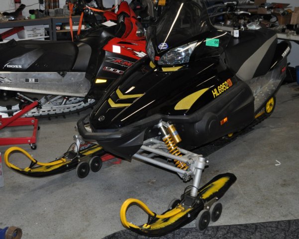

The latest version. Painted black and orange with the hanguards, skis, riser, and bars on.
SWEEEEEEET! I did a shorty like that several years ago it was blue but wanted black! is that a Polaris seat
Purplecoffin
It's a skinz seat for an apex. I had bought an apex seat that I never ended up riding. Found these that were a bit under 7lbs if I remember right.
She is down almost 80lbs from stock and this seat was even taller than the apex.

I did cut the X right behind where it came together. I will try to get some pics Thursday or Friday. I have to get it out of the trailer to reload to head north Friday afternoon. (Sleds only fit loaded in the right order. Lol )
I did weigh it before and after my mods but don't remember the numbers. I know that it was down 78lbs weighed like three times.
I used blocks of wood and moved the scale to each ski and track while maintaining level by moving the blocks around. It was empty of fuel at the time, as I had the fuel tank off.
I have done a couple more small things since weighing it so I am sure it is down 80 plus now. When the battery dies I will do something there too.
The sound was great stock. I rode the sled about 300 miles before I started tearing it apart. The only thing I liked stock was the motor.
The super trap works well. I started with no disks on it and it was way to loud!!! Added several discs and washers and it settled into a decent tone low and midrange. Still a bit louder than I like with the throttle pinched. I probably ended up with like 20 bucks into the exhaust but I already had the muffler.

One thing I didn't mention before is that I added a kind of block off under where the stock muffler sat. I had a lot of ice build up before adding that. Now I have very little ice build up at all.
The sound is very similar to a street bike at speed with a bit more thump at idle.
