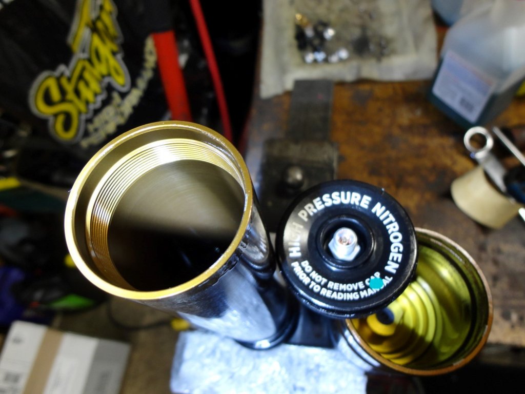

The biggest thing I found in riding on and with the sleds with the two shock packages(QS3R/QS3)is the R's had a much broader range. They did not need to be clicked from 1-2-3 all the time to be very comfortable. I will say it again though. True Fox QS3R shocks are even better than the Factory QS3R shocks. Custom valved and better components. Check out these parts on a true Fox shock. Actual Schrader Valve Nitrogen fill,Anodized IFP,Kashima coated inside and out. Not shown are shotpeened light wieght springs for front and Heims instead of cheap bushings. Sometimes they are less $ than factory.
