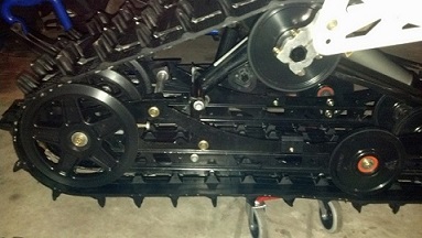

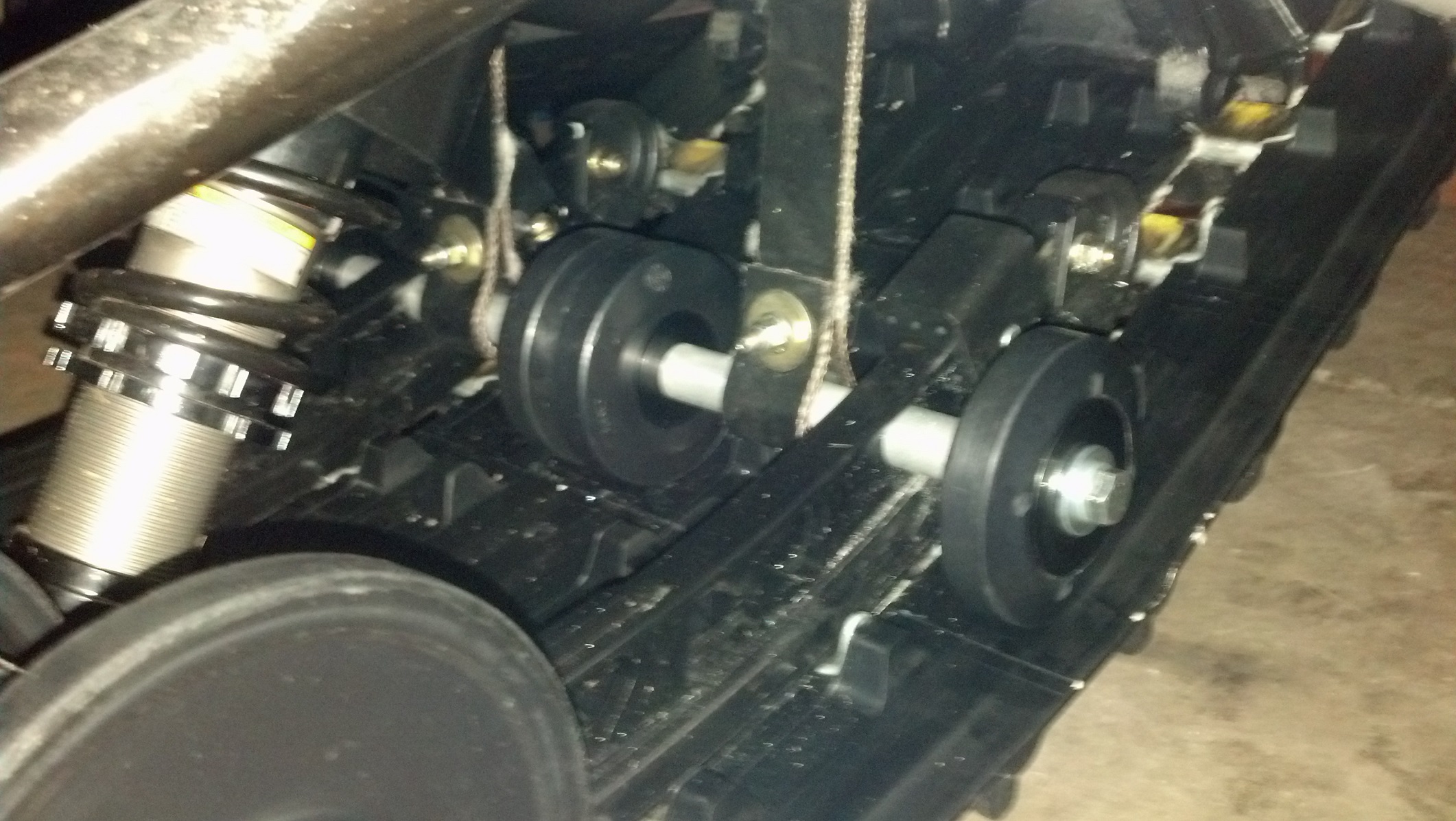

RTX said:tator said:guess i got a quiet one. more wheels and some dupont slides make a big differance also.
Ya im a huge fan of the dupont slides. I have had real good luck with them on the apex.
They are on the list of things to do.
Do you have suggestions on cheap wheel kits?
I have some pictures of my set up with the wheels if you would like to see. With the extra wheels and the duponts it's a lot better, but sometimes I hear a little track noise. But way better now! And there is no sign of wear on the hyfax.

YamahaTim said:RTX said:tator said:guess i got a quiet one. more wheels and some dupont slides make a big differance also.
Yes absolutely i would like to see them!! Can you put them up in this post?
Tim yours was pretty loud in the track/suspension too before the wheels and hyfax?
