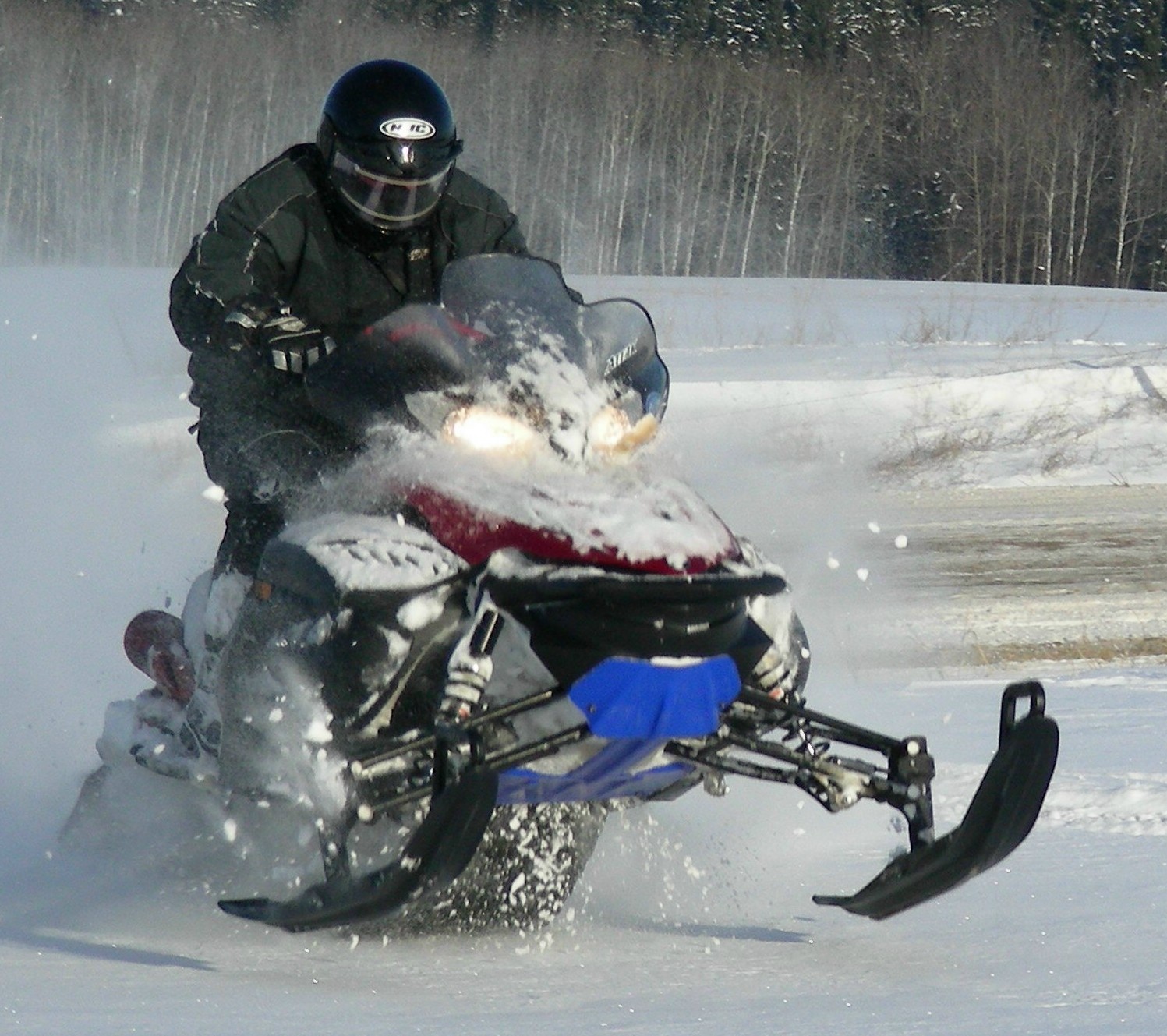

In an enlarged view of my avatar you can see the bend of the rear span on the lower left (your right) a-arm. By the way, that is the Pioneer wide front end kit. Two rides after this photo was taken all four a-arms looked similar to that one and I had to replace them all...again. Just figured out how to attach a photo, so I thought I'd put this on here so people don't think I'm just bashing Pioneer or Yamaha.

Hmmm,looks like they need a little more beef on those arms. Do they claim that there're cromemoly.or steel?
