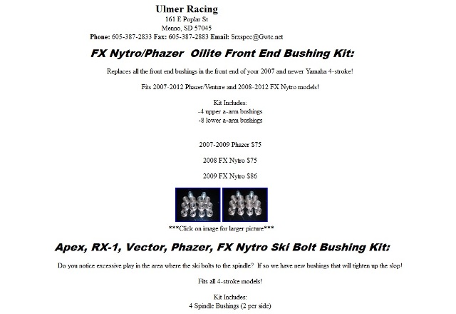

Not sure what material they are made of but Ulmers bushings are not oillite. They are solver colored and slightly magnetic.I have never worn one out and highly recommend them.

I'm not sure what you installed but Ulmer's bushings are oilite as stated on their website. They last longer than the OEM bushings and are a good alternative. I've seen worn oilite bushings although they did outlast the OEM version by several thousand miles.
http://www.ulmerracing.com/

Thanks for all the feedback Grizz. I currently have ulmers "oillite" bushings and upon disassembly found that a few of the real small shoulder ones are broke. They arent wore out so I think I will just throw them back in and save a little money.
