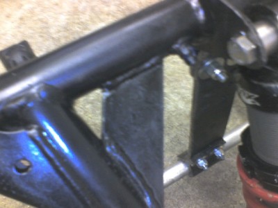

The front pivot arm (swing arm) broke straight off, probably when going over a lot of stutter bumps. I hear A LOT of other Phazer owners have had problems with their rear suspensions and most often the front pivot arm. I see this as a clear case to be warrantied. I haven't even abused it. I'll talk with the dealer Tuesday about it. If not warrantied I need to start looking to buy me a Lynx with a PPS rear suspension. They seem to be able to handle anything.
Attaching an image of the mess :-(

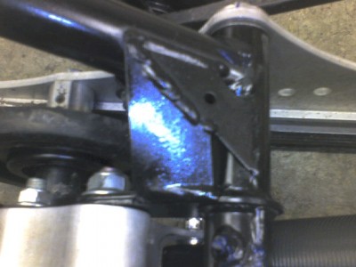

I will be gusseting mine over the summer. Anyone got pics of a reinforced one?
peanutbutercups
My updated one also snapped several times this winter. Found it was easiest to just get it welded, but will definitely get it reinforced this summer.

My shaft probably cracked just about where the one you are showing did and then when it fully broke the arm broke straight off as well.
Got my welded yesterday, hopefully it will last for some days of smooth riding
until I get a new one.

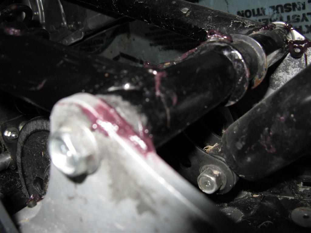

fraolib
fraolib
but he even broke this one i do believe. if i recall he only got about 700mi out of it

fraolib said:but he even broke this one i do believe. if i recall he only got about 700mi out of it
Yup that is my reinforced arm. It did finally break, however lets be honest the abuse I put on a race sled for one arm top last 700 miles is pretty good. The factory race sleds are breaking suspension parts at some of these races.
In munising a couple cat riders snapped there shocks in half.
