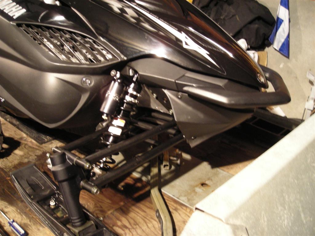

apltx08
In order to level your front arms you have to get your shocks SHIMMED/shorten the travel by 5/8" by a rebuilder...I had mine done last year and what a difference it made as Quebecer#1 mentioned earlier...here's a before and after pic.

Getting back to the post , Does the Apex Ltx have more travel than mine a 07 gt ? Is that the reason for the shimed front end ?

some guys wanted to go in the Lac St-Jean area and where told to stay home cuz of lack of snow!APEX'S all have the front end specs, shock is 16 1/2" c/c and got mine shimmed/shorten to 15 7/8" c/c.
Robert from Star Susupension set me up, by doing it this way you can run more preload on your shocks and keeping your arms level, be careful if you don't have enough preload your SPRINGS can come out of place and collapse the suspension and LOSE control...jack your front end off the ground to fully EXTEND your shocks and check your preload to see if your SRINGS stay in place not falling off retainers or coming out of place in anyway.

No the thinking here is if you want to LOWER your COG you have to shorten the travel somewhat and that is why you SHIM your shocks travel so in reality you end up having a longer OE spring...but you still want to run with near zero preload to benefit set-up.
apex55
Sorry for all the questions, but here is another. By running the a arms flat lowers the sled. Also shortening the shocks would also. Does this create more bottoming out on the front end and/or taking more hits on the belly of the sled?

apex55 said:Sorry for all the questions, but here is another. By running the a arms flat lowers the sled. Also shortening the shocks would also. Does this create more bottoming out on the front end and/or taking more hits on the belly of the sled?
I am a believer of making a single adjustment and evaluating it so you know what changes occured with the mods. I ran 320 mile this weekend with the pilots skiis and shaper bars and what a difference. Ii will lower the front for the next ride, which may be awhile seeing as Vermont is near 50 today with a dumping rain.
I did lower my front and have rode about 200 miles so far on many different types of terrain and she still handles the bumps well.
Seems like im a little faster on top ?

First ride with the suspension dropped and the improvement in handling was exhilarating! Thanks!!
