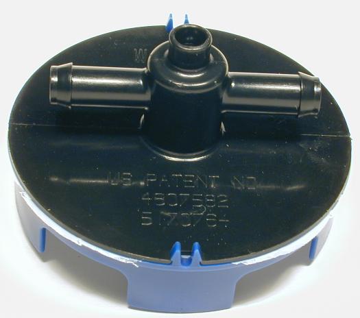

, I tried 2 of them last week end and it's not working at all. it still sucking air and not close properly under big accel. engine shut off when WOT. do you think is air coming because it not closing or just because I have restriction like you said?![]()
longsled,
At the hp level I think your at, you need to pull off at least two in the back of the tank under acceleration. They have to be single outlet (not flo thru like in this picture) with T's to divide fuel line. When you pull through one of these it shuts when the fuel goes to the back of the tank and pulls a vacuum on the remaining one in the back causing it to close even though it has fuel. If they shut, the motor dies. If you are sucking some air it usually goes lean but I have never seen these suck air.
longsled
humm, I still having problem only when fuel is low and only at 12-14 psi.
I resolved the problem by adding a surge tank and a auxiliary fuel pump, I'm a bit tired to removed that fukkking fuel tank to do testing.
I will let the fuel pump for a while.........
thanks for your help.
