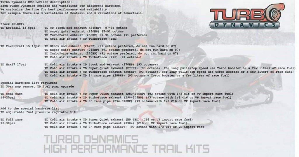

Saw this on TD website and thought I would post. Could be old I don't know. I guess what caught my eye was the Fuel recommended for the 17 psi tunes.. thought it was interesting..

Information I could have used about 3 years ago

I have never seen anything but 91 (labeled that anyway) where I ride! Sure glad I always splash some octane boost on every fill up. Cheap insurance

Thats older info, I think it was in the early development of the tunes. On my tune bundle it only lists 93 for max spool 20 and 93 octane with c16 for maxspool 19 which is the same flash as max20 in terms of boost but a leaner tune that requires the big fuel pump. Maxspool 17 , max17 and powertrailand all say 91 on my flasher and eco says 87.the bundle was purchased this fall.

93 for max 20? Do you have the fuel pump and regulator?Thats older info, I think it was in the early development of the tunes. On my tune bundle it only lists 93 for max spool 20 and 93 octane with c16 for maxspool 19 which is the same flash as max20 in terms of boost but a leaner tune that requires the big fuel pump. Maxspool 17 , max17 and powertrailand all say 91 on my flasher and eco says 87.the bundle was purchased this fall.

Just the pump installed. I have the regulator but its not installed.93 for max 20? Do you have the fuel pump and regulator?

That's good . I just ordered the pump and plan on running max 20 next year. 93 is readily available around me. Perfect.Just the pump installed. I have the regulator but its not installed.

Funny I just downloaded my new tunes for the fuel pump and it shows 98 octane for max 20.Thats older info, I think it was in the early development of the tunes. On my tune bundle it only lists 93 for max spool 20 and 93 octane with c16 for maxspool 19 which is the same flash as max20 in terms of boost but a leaner tune that requires the big fuel pump. Maxspool 17 , max17 and powertrailand all say 91 on my flasher and eco says 87.the bundle was purchased this fall.

No Kidding, lol .......mine definitely says "93 octane min". It doesnt need octane that high imo,unless your giving it the pickle for real long distances over and over again, imo. On that tune with pump 91 with a little boostane to raise it to an estimated 93-94 octane I showed a max of .2 degrees of timing retard on about 2500-3000ft pulls at 20.5 psi.Funny I just downloaded my new tunes for the fuel pump and it shows 98 octane for max 20.

Ya, I think this is old...Saw this on TD website and thought I would post. Could be old I don't know. I guess what caught my eye was the Fuel recommended for the 17 psi tunes.. thought it was interesting..
I actually like the octane guidance in the TD chart. Its always better to be conservative with the varying boost levels we are all running our 998s at.
I run the Hurricane SM and PM tune bundles and even though some of the selections are said to be safe on 87 octane I would only use 87 if there was no higher octane fuel available and then I would ride accordingly.
Typically I always use 91 fuel with Torco octane booster added no matter what tune I am using.
