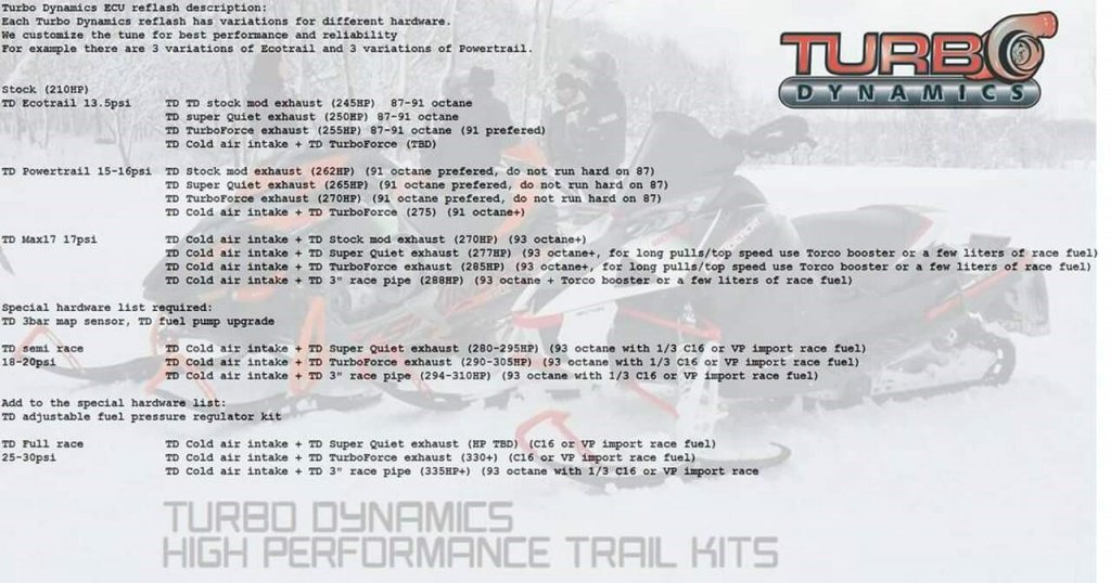

Agreed. It's a good guide.I actually like the octane guidance in the TD chart. Its always better to be conservative with the varying boost levels we are all running our 998s at.
I run the Hurricane SM and PM tune bundles and even though some of the selections are said to be safe on 87 octane I would only use 87 if there was no higher octane fuel available and then I would ride accordingly.
Typically I always use 91 fuel with Torco octane booster added no matter what tune I am using.

Saw this on TD website and thought I would post. Could be old I don't know. I guess what caught my eye was the Fuel recommended for the 17 psi tunes.. thought it was interesting..
No doubt, those octane numbers are conservative if you are riding with your wife and kids, but for all other types of riding, I would follow those recommendations religiously.
Be advised, those recommendations are not retard proof. Back to back pulls extending a mile, or even fast trail riding with constant speeds over 120mph for miles on end require even higher octane.
Good fuel is like a wildcard, and will blanket a plethora of other issues such as high AFRs, high iats, too much timing, cold temps/over boosting etc.
As people pack on the miles and continue to run bigger tunes, we are starting to see more engines going down. Imo, many of these catastrophic failures could have been prevented with proper fuel.
