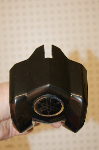

I drilled the stock Riser and attached a RAM Ball Mount (UBolt Mount Ball) with stainless hardware:
I slotted the stock "pad" if you can call it that, to fit down over the bar of the ball mount.
