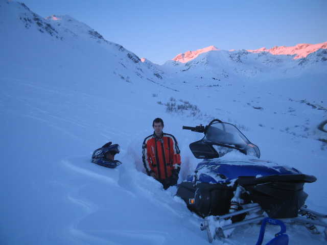

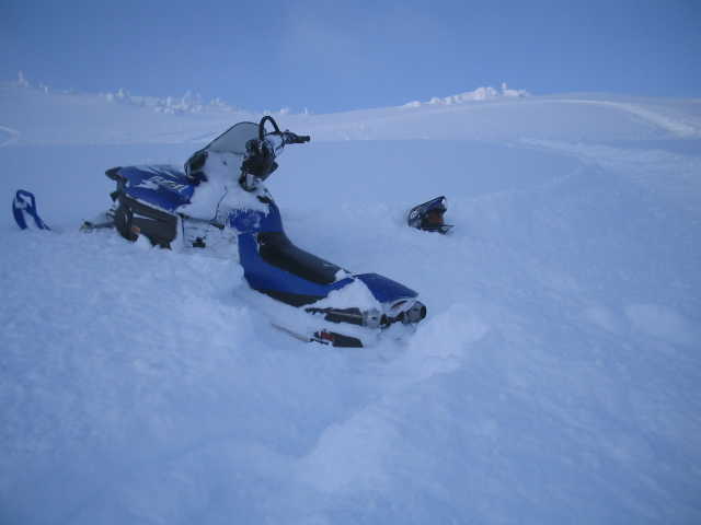

Hey, your stuck there.
MOUNTAIN VMAX4
6'2
What you dont know though is that I am 6'2 and the trench is about 4.5 ft deep. LOL Alaska Powder for ya.
AaronBND
No lie......with the Maverick track and the mods done to my sled I have done, I can ride in that bottomless powder all day long and not get stuck anymore. Night and day difference when they are moded right! Looks fun!
