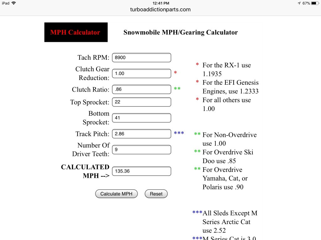

Well if they ran stock drivers at 8900....they are around .86 ODGuy with 22/41 gearing ran 135 gps on ice with TD Max17 the other day. How much overdrive is that?
But they may be running a lower lug track with 2.52 pitch to get those speeds, more details needed.

Yes sir... 135 gps on the lake multiple witnesses... It was friendly competition and he took the honors...135 with 22/41 gears is completely maxed out... Efficient to 132mph and he only got. To 135 because he had a lot of power with the powertrail V4, Another customer ran 131mph gps but he was spinning Soo much he had speedo showing 139mph because his dull studs couldn't hook l. He had 21/38 gears which are taller.Guy with 22/41 gearing ran 135 gps on ice with TD Max17 the other day. How much overdrive is that?
Originally I wrote max 17 but the owner confirmed it as powertrail not max 17

wow that is rocking with that map Ben......so 22 top gear sounds like 135 is achievable with stock drivers and track, just need the power to get there.

I can't confirm if it was stock track and drivers, maybe Ben will chime in.wow that is rocking with that map Ben......so 22 top gear sounds like 135 is achievable with stock drivers and track, just need the power to get there.

I am skeptical about this...wow that is rocking with that map Ben......so 22 top gear sounds like 135 is achievable with stock drivers and track, just need the power to get there.

I assumed since he did not put anything else into his post the rest was stock.I can't confirm if it was stock track and drivers, maybe Ben will chime in.

I dont doubt the calculator at .86 OD, also he could be revving over 9k.I am skeptical about this...![]()
But those speeds sure are not easy without a tail wind if track is stock. Hope Ben chimes in about any track and/or driver changes.
