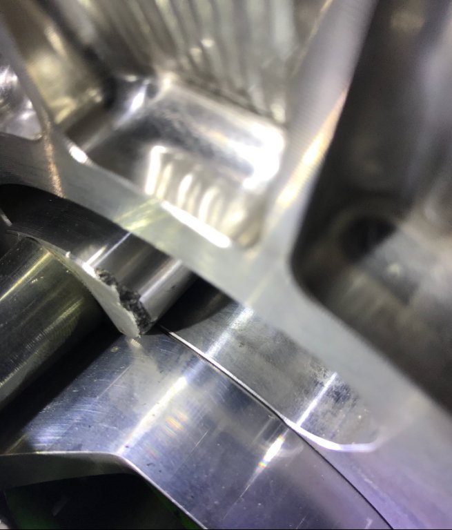

I’ve ran 128 gps with 21/41 gearing running it to 9250 rpm. I’ve also ran 136 mph with 21/37 @ 9000 rpm. Both with stock 1.25” track. I’ve also ran 133 mph in 1320’ but that was with 1” track. And I’ve fully bottomed out my secondary and have the marks on the tower to show
not sure how maybe had a short belt? But regardless it was Fully shifted in secondary at least

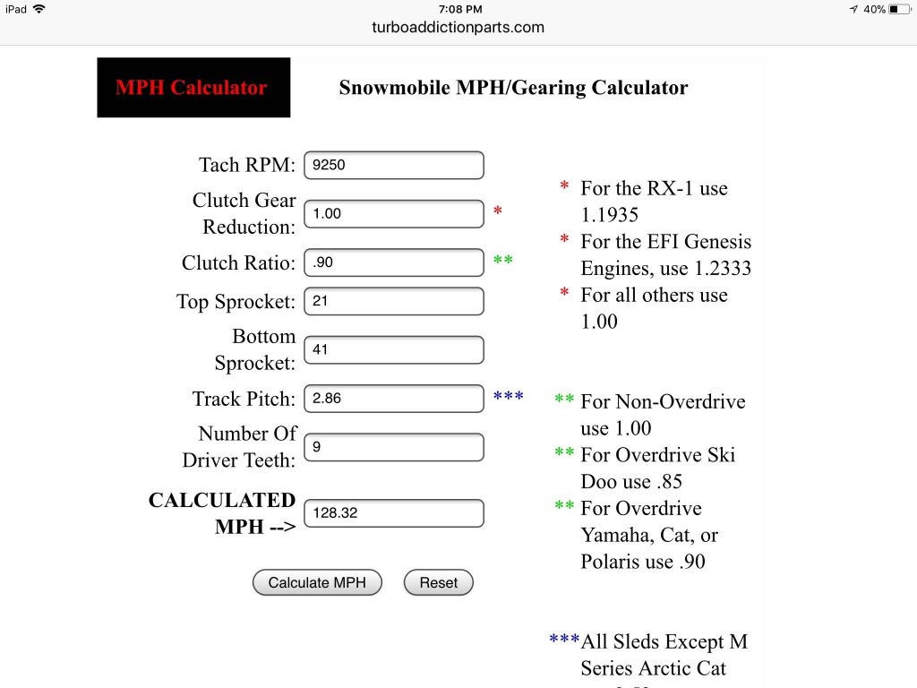

That is rolling brother! 128gps with stock track and gears, nice! How much boost for that run?I’ve ran 128 gps with 21/41 gearing running it to 9250 rpm. I’ve also ran 136 mph with 21/37 @ 9000 rpm. Both with stock 1.25” track. I’ve also ran 133 mph in 1320’ but that was with 1” track. And I’ve fully bottomed out my secondary and have the marks on the tower to shownot sure how maybe had a short belt? But regardless it was Fully shifted in secondary at leastView attachment 133590
It comes up at .90 OD for that.

14.8 PSI that day. That was on hero snow..but not plowed ice. I’d guess about 2000’ run. I was just out testing on the lake at my placeThat is rolling brother! 128gps with stock track and gears, nice! How much boost for that run?
