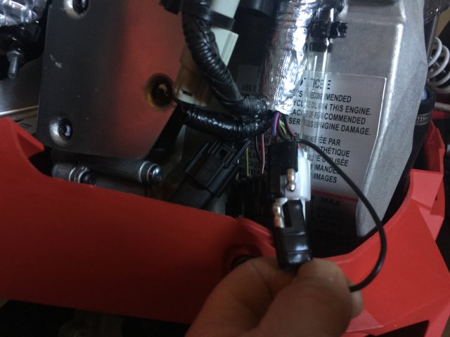

Is this just a built in trickle charge point?
Now I understand the multi SAE splitter orders. Damn can those SAE connectors be bought locally instead of waiting for China delivery?
On my sled my dealer tapped those wires with solder connection on other side near hood plug for heated shield.

That's it.
There's 2 of them as shown.
I've plugged my Shield and an aux USB plug into one, and have the other as a spare in case I mount a GPS.
I'm just not sure what Fuse they're connected too?

I don't think there is 2 or at least I could not find the 2nd one. The picture shows the power point and cap and I used it to wire up the LED's in my hand guards. It worked real well and is wired to the key on/off. Anybody know where to find the 2nd one?That's it.

There is only 1. the other 1/2 only has a ground wire no +
