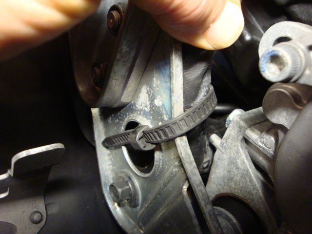

Dr. FeeLGooD
behind primary clutch- harness rub on nub on motor mount
https://ty4stroke.com/attachments/dsc02880-jpg.104633/

Nice find, thanks for posting.behind primary clutch- harness rub on nub on motor mount

So after ripping it apart and chansing the harnes i found two shorts. One yellow red.(grip warmers) and one grey and red(ignition coil 2) they were both worn threw and contacting my frame wich explains the misfire and blowing a coil and code 81. This exposure was directly underneath the top steering post bushing clamp. Had to remove tank and panels and pull down on the harness tucked underneath there is a factory screw that cut threw
