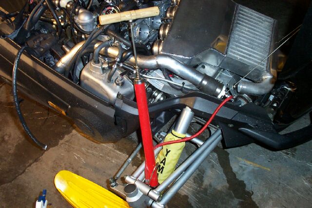

Ok i am going to presure up the charge tube from turbo to the intercooler. Will let you guys know what i find. I did block off the B.O.V. too.

Well Well!!! The new TurboXS leaks like a pig. With a hand pump it will not even hold 1PSI! That has to be it, then when the B.O.V. gets warm the metal expands a little bit and i bet it leaks even worse!! And the Bender turbo i am running is maxed out at 13psi so it just cant keep up! Right??!!

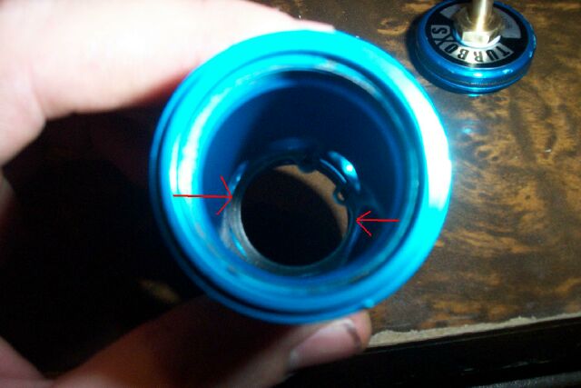

No the valve is not opening it is just leak around the two parts! The inner pluger and the outter shell.

Skydog, if I'm not mistaken, I believe that that BOV is a poppet type valve and the seat of the poppet might be damaged or has something in it that is preventing it from sealing. Or it may be the the o-ring on the spring side. The op of the valve where the hose connection is screws on and off. Perhaps this is loose or like I said a bad o-ring.

Here are a few pic. of the BOV as you can see there is no o-ring for the pluger to seat on and seal when closed? One o-ring for it to seal to the pipe i welded on the charge tube. The pluger just sits on a c-clip! Maybe it i could get a o-ring and put on top of the c-clip to make it seal? Is it missing this from new maybe??
