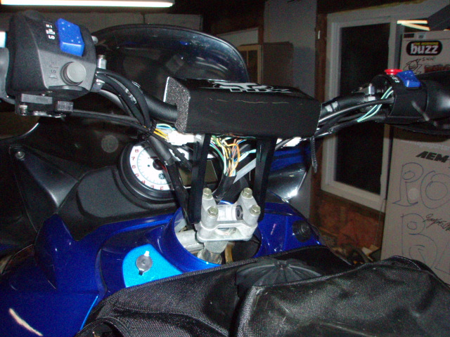

Rox Riser
Heres what I did, a 5" Rox Riser with Motocross bars, which equals to a 2" riser with stock bars.
Ok I put the Rox 2 inch riser on and moved the bars forward and up but need to turn the controls down, did the throttle side but don't see screws on brake side what am I missing are the screws hidden?
screws are on the bottom, and when unit is separated there are 2 allen bolts that hold it together.
