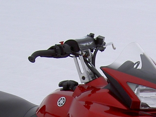

The OEM bars from the Arctic Cat SnoPro 440 (I think the same bars were also used on the F7).
I had them on couple of sleds and I loved them.
The pictures show these bars on my old -05 RX-1.
Though, if you put them on the FX Nytro you will need a higher than OEM riser because the bars themselves has got zero rise.
