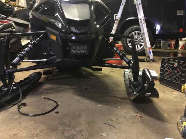

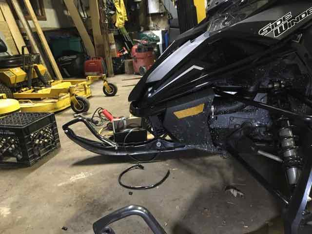

Just finished the light. Also added the Doo 6.9s and Travis' MPS kit. Can't wait to get this thing washed and get some snow up north. I will attach a few pics of the finished, but dirty, product. Thanks to all for their help on all 3 upgrades.
It will be like a new sled!
