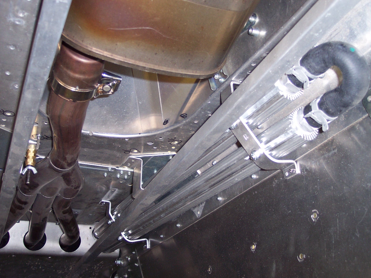

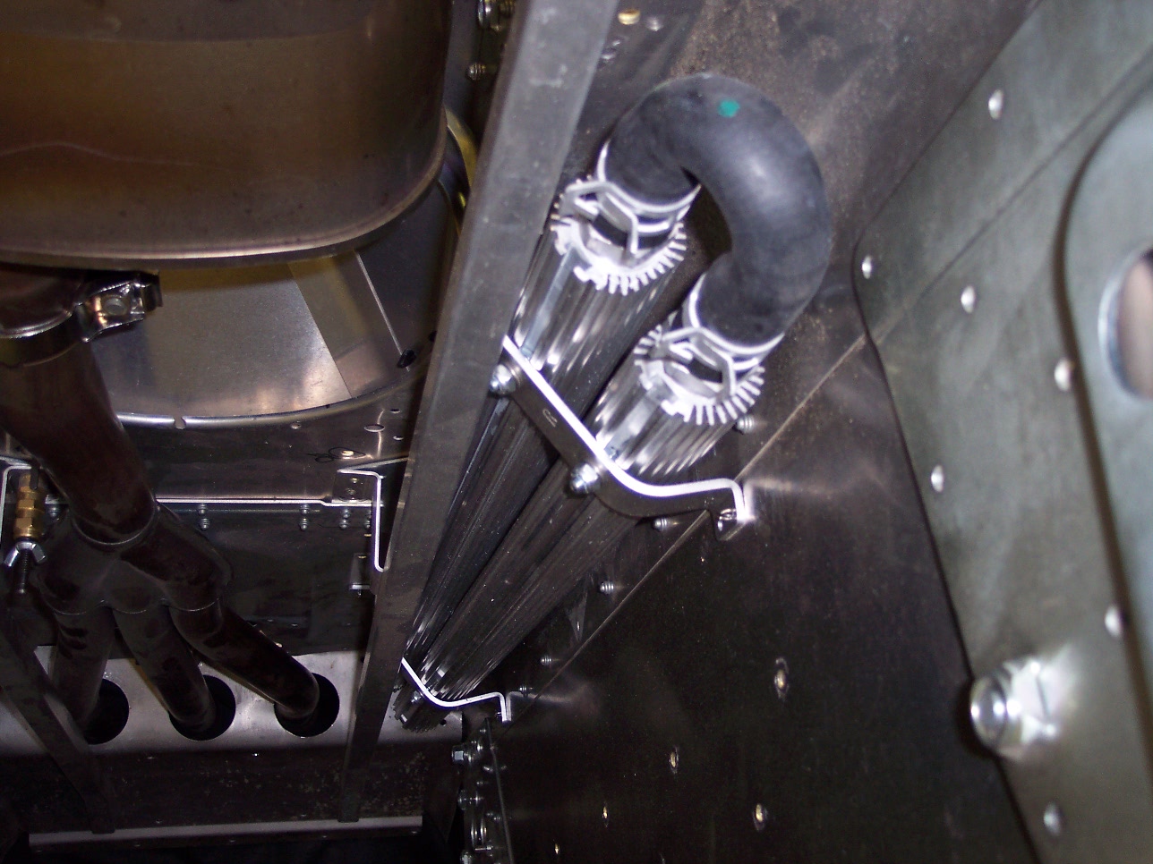

I have no numbers yet for this cooler in a short track application. This extrusion worked well in my turbo sled last season. I used it in conjunction with a small rear cooler with the rad deleted. 162 track and 16lbs. boost. The OEM MTX tunnel cooler extrusion is about 18" long so when I decided to offer a version for the short tracks I made mine 30" long.

Ok. I would be running it with a supercharger and keeping the radiator.
Mountaintech
This should work well for you. I found that before I turboed my MTX, I would still have my temp light come on occasionally on long streches of icy hard pack with no scratchers down. Put down the scratchers or drag your feet and the light would go out.
