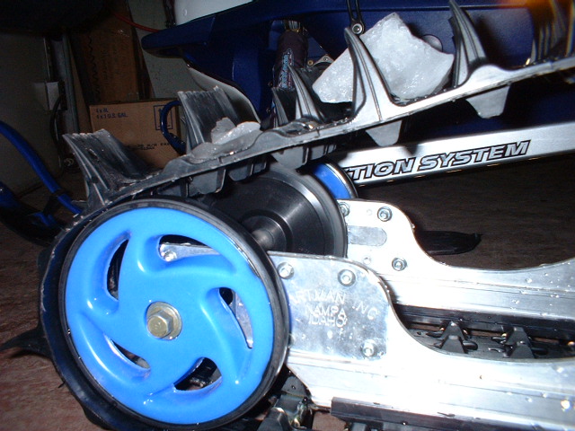

Found the line I was missing. The picture was misleading me on my hose routing. Got everything fixed and now it purrs like a kitten. Now my only problem is Hartman sent me the wrong rail extensions so my track is banjo tight with the adjusters turned in as far as they will go.

Hartman probably sent you the extensions for last years rails like he did with me, they work fine if you just round the corner off and drill another hole. I also just changed the oil return line location, instead of a tee into the line on top of the oil tank, they want it teed into the line that goes from the new plenum mounted tank down to the fitting on the timing cover.
