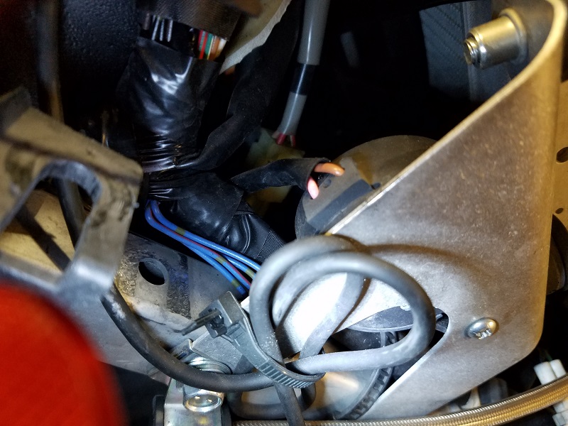

Here are some pics from my 08' RTX. The 1st one is the pink and blue with red trace wire connector. This connector plugs right into the reverse buzzer which is mounted on the inside of right side radiator bracket.. The 2nd pic shows the buzzer. The 3rd pic is the tail lamp harness connector which is located behind the right side black gas tank panel and were it meets the reverse handle trim plate. Let me know if you have any other questions or would like to see additional pics. G.B.
