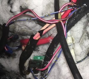

Working on a friends Nytro which he had one of his others friends try to fix.
As you can see, they hacked the wiring pretty bad.
Does anyone have the wire combination for the starter relay. I'm going to wire in the updated starter relay but have no idea which wire goes where.
I can see:
(qty 2) Blue with white stripe and green marks
(qty 1) red with green stripe
(qty 1) red with white stripe
I included a pic of the relay and numbered terminals
1.?
2.?
3.?
4.?
Really hope someone can help.

Thanks Dr. FeeLGooD,
I actually figured it out with help from the picture in the thread you linked.
1. Empty
2. Red with Green stripe
3. Red with white stripe
4. Blue with white stripe and green marks
Those other wires were going to a resistor or something that I thought they just threw together when they unwrapped and tore everything apart. So there was only three of the wires going to the relay.
1. Empty
