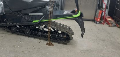

Just finished working on a xtx. Guy wanted to run a 144 track with 2.52 drivers for more selection of tracks
I went with 10 tooth 2.52 pitch avid drivers(around 500$ Canadian) and it leaves about 1 1/2 " of adjustment after tightening track.
If you have a 2017 or 18 you will need to replace the adjuster bolts with a allen head drivers studs
part# 8jp ra194 30.
part# 8jp ra194 30.

This can be done without a tunnel extension?

Sorry he pick it up today I forgot to take pics..Great info.
Any side profile pics of how track fits in tunnel and snow flap area?
What track did this person decide to use?
I planned and prepared to change to a 144" track when my sled was new but I ended up liking the Back Country 1.75" 141" track so much that I have not done the 144" conversion...yet.
Not really much difference maybe 1 inch with
10 tooth driver.
He went with camso ice cobra 1.6 with studs at the end of lugs.

Yes no extension just 10 tooth driver and longer adjusting bolts (2017 /2018).This can be done without a tunnel extension?

I did the same thing. Wanted more traction so went to a challenger 144 cut down to 1.5 and installed 2.52 10 tooth drivers.
Only modification was on the rails tips. It may depend on your suspension set-up.
This is the best mod I did to my 141.

Was there any changes to the gearing ratio?

No he stayed with 21/41

? for Marc, does the clearance in the tunnel change much with the 10T? Just curious if it effects stud length options?
