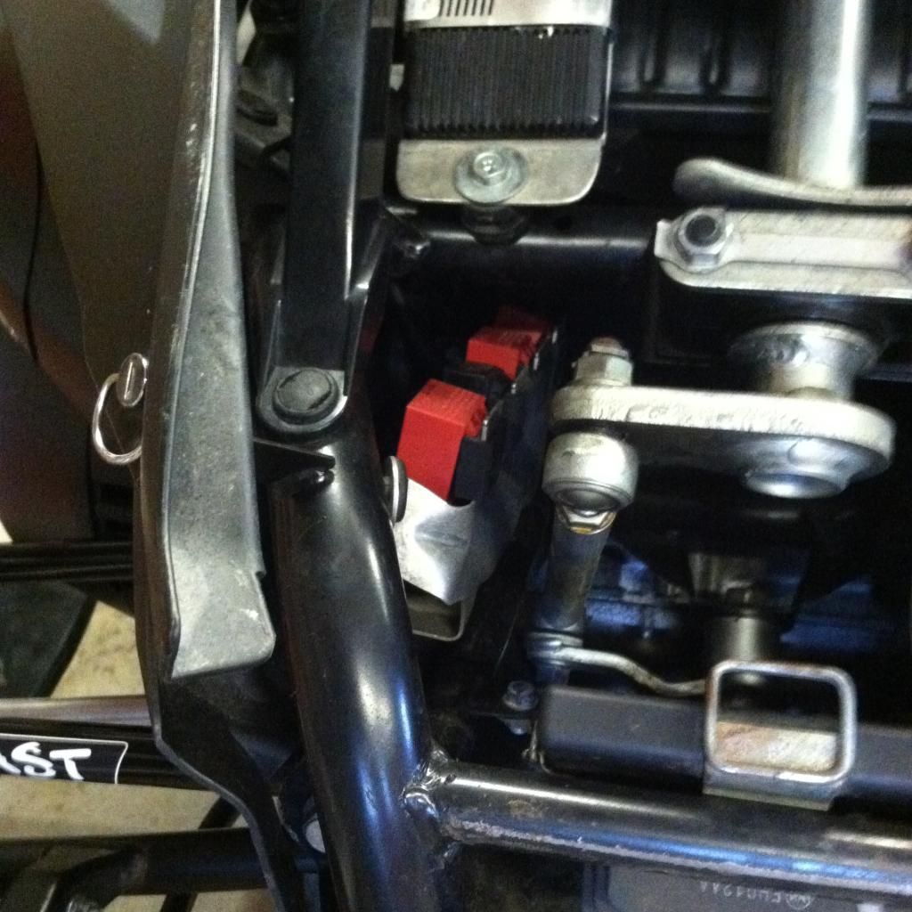

Now I have possessed lights on the wife's sled. Yesterday we were out riding in cloudy snowy conditions. Then we hit the freezing rain again. Things were going slow and we made it to a warm up shelter wait out the freezing rain. Get into the shelter and look out only to see the wife's sled turn on the lights by it self. Started the sled , ran it for a few minutes and shut it off , lights stayed off for a minute and on again.
It was strange, I pulled the headlight connector for the hi/low switch and the lights went out but the tail light stayed on. Went into the fuse box by the reverse lever ( what a PITA to open) and pulled the fuse there. Lights went out and tail light stayed on. Checked all the other fuses and they were good. Could this be the headlight relay or the load control relay stuck. There was a bit of snow in around the relays but not very much. Just what ever blew in there.
Disconnected the battery last night after we got home. Checked the sled this morning and just connected the battery bolt and the + lead to the sled. No power lead for the HID lights. Tail lights came on. Sleds were in a heated shop.
So I am thinking it is either the Load control relay or the headlight relay. Never unplugged the HID from the head light socket connection but they are getting no power from the battery so that should eliminate the HID relay.
I also put electrical tape around the relay and then put a piece of shrink tube over that to keep any moisture out.

nitris223 said:Now I have possessed lights on the wife's sled. Yesterday we were out riding in cloudy snowy conditions. Then we hit the freezing rain again. Things were going slow and we made it to a warm up shelter wait out the freezing rain. Get into the shelter and look out only to see the wife's sled turn on the lights by it self. Started the sled , ran it for a few minutes and shut it off , lights stayed off for a minute and on again.
This is the load control relay.
It has gotten moisture in it & was sticking closed, keeping everything on.
It is almost impossible to get the moisture out dependably.
Best bet is replace it with the new Yamaha RED relay.
If your dealer doesn't know what they are, Port Yamaha has them, they are a site sponser here.
Hope this helps!
Rock

My dealer has the red relay but claims they will only work for the fuel relay. I then asked them why they are all the same part number. If I ask for the load control it should have a superseded part number which matches the red relay. I am going to try them and see if they try and give me the old black one. I have our two old ones still so I can pop one in to verify. Just need to find out which one is the load relay on a 2011 MTX SE.

I knew you guys were right and the dealer was wrong. Grizz do you know which relay on the 2011 is the load relay. I have changed the fuel relay which had 3 red and 1 blue or 3 blue and 1 red wire. One of those combinations. It was the front one on our 2011`s. I think a 2009 xtx I did was the 3rd back from the front.
I am going to print the picture and take it to the dealer.

Red , Brown, White and a Brown with a blue tracer. Thanks I will check that out later.
