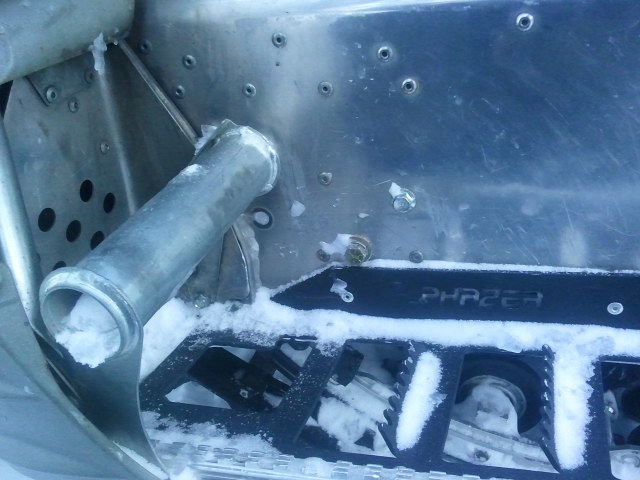

gotcha, I am almost done with it. not sure if I will have to move some holes or not yet. But will put pics up when done.
pic of new hole
this is what my front mount hole looks like. would have posted the rear one but mount tammer mounts different.
