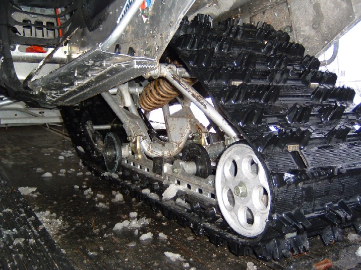

SIMMER
Guys this is from a post that "Dano" made early in April about the new snocross sled fro Yammi. Is there any noticable differences between the W-Arm on your 2005 and this one on the snocross sled?
I don't own an 05 to compare it to but it "seems" that the bottom of the W-Arm looks to be heavily reinforced compared to stock consumer models.
Do a 360 degree VR of the suspension on the Yamaha Website and you'll see what I mean.
http://www.yamaha-motor.com/products/sno/media/vr/06/apexRTX_vr0820.htm
ReX
Wow! Now that's a beefed up pivot arm (w-arm). It's hard to even recognize compared to the stock one.
I want one of those on my machine.
A couple of things I noticed also:
- The slide rail isn't reinforced where the middle idlers are and it almost looks like it has the classic 05 mono crack starting (smile below the bolt that holds the middle idlers on).
- It looks like they've suffered from the same hyfax retainer bolt failure that several of us have. The wear mark (down to bare metal) on the rear pivot arm looks exactly like mine does
- The rails have been lightened with numerous slots
Is this sled built by Yamaha? It's interesting to see how incredibly beefed up the w-arm is.
