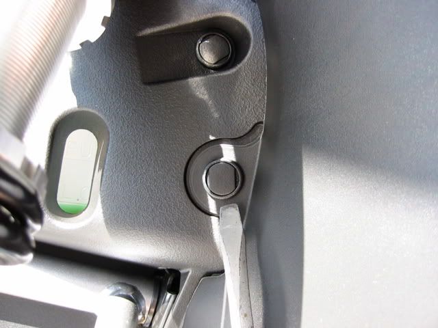

I'm going over my XTX seeing where everything is and how to access certain components. I want to get to the oil filter and need to remove the lower side covers and bottom cover. The manual says to remove the "quick fasteners" and doesn't explain how this is done. Do you pry it off with a screw driver or push it in? First sled I've had with these fasteners.
It's the round fastener's that the screw driver is pointing to.

Use a little screwdriver to pop them up!

You could use that screwdriver, I have one with a bent tip that I use. Those things basically pull out. Put the head of the flat top under the flat side and give a little twist. They are like wall anchors, when the screw in inserted, the ends push out.

Just make sure that the screwdriver is not too small, then you will just damage the plastic screw.
The screwdriver in your picture looks OK.

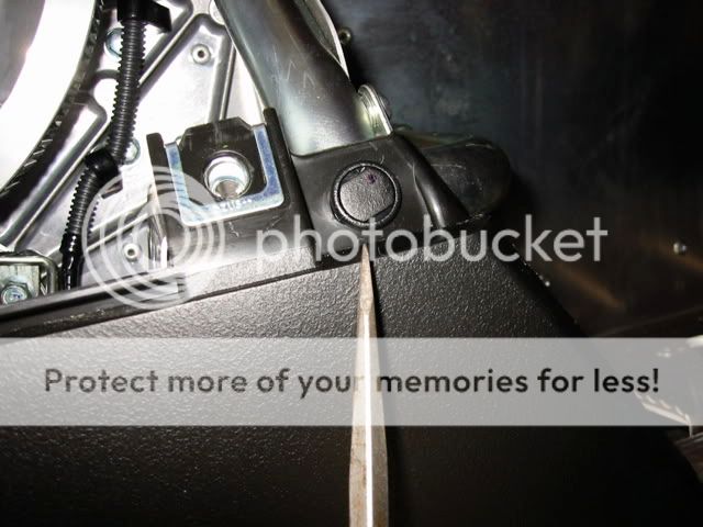

I don't know if this is any different than what was said above, but after I pop up the center piece I put my screwdriver under the round piece and it seems to come out easier.
