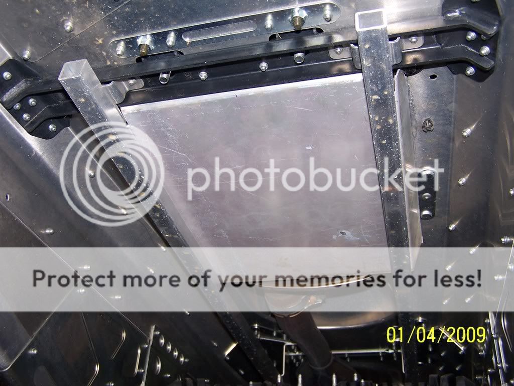

i removed the tunnel protectors,no more ice issues at all,no overheated cover issues ,easy fix in my opinion but im not studded either,good luck with all the plates

Any other ideas besides hammers for guys with heat exchangers, that need the tunnel protectors?
i have this problem will try and cure it once the snow is gone do not want to miss any sleding. My wifes phazer had a similair ice problem and i cured that with blocking the tunnel off. her tunnel now stays ice free, so will get er dun
