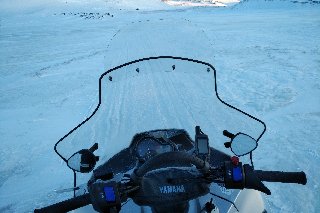

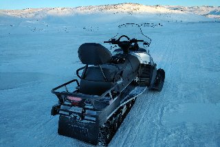

Well pulled the trigger on the VK Pro. Had the tunnel exhaust mod done, added the 11" ski skins, Woody cabide runners, marginal snow kit (set bogie wheels). Had it out today 50 Km's -25 celcius - 34 with wind chill! Added an extra wind screen on windshield.Pros: lots of power, comfortable and warm sled to ride... Minus the hand and thumb warmers ...more on that below. Ice build up in tunnel very marginal. Handles well on stutter bumps. Lots of storage. Under seat stays warm. Haven't pulled anything with it yet, want to get at least 150kms on it first. Gauges good, readable while driving. Good placement area for gps.
Cons: it is a very heavy sled as folks say!! In short turns- twisty trail it still is tippy compared to the Expy and Renegades. Ski skins extra wide does help. Found the hand and thumb warmers even on highest setting to be cold today. Have to review that! Mirrors,, they don't want to adjust up. Design seems to be poor. Will report back after 100km's .
Initial impression is great sled, will need to get "used" to handling characteristics and style.

Your mirrors need to be swapped from left to right common mistake that the dealers make, regarding the tippiness, with the ski skins on the whole carbide including the host bar is on the snow, if you're running ski skins, only thing that I found to work on my 06 pro was the quali pieces cobra heads or the semi aggressive snow trackers . With those installed that sled would rail around corners at high speeds effortlessly. The sled only has a ski stance of 38.4 center to center which is narrow compared to anything else in this class. good to hear you're enjoying the sled! cheers!

The mirrors, hmm.. Easy fix....will do it.Your mirrors need to be swapped from left to right common mistake that the dealers make, regarding the tippiness, with the ski skins on the whole carbide including the host bar is on the snow, if you're running ski skins, only thing that I found to work on my 06 pro was the quali pieces cobra heads or the semi aggressive snow trackers . With those installed that sled would rail around corners at high speeds effortlessly. The sled only has a ski stance of 38.4 center to center which is narrow compared to anything else in this class. good to hear you're enjoying the sled! cheers!

Went to the cabin and overnighted., -38 without a windchill. Windshield still frosts up and is basically useless driving with visibility. Anyone else having this issue? Tried drilling two holes quarter inch diameter to get heat from engine onto the windshield below the dash, but seems to be worse or no better than before! Any suggestions?
