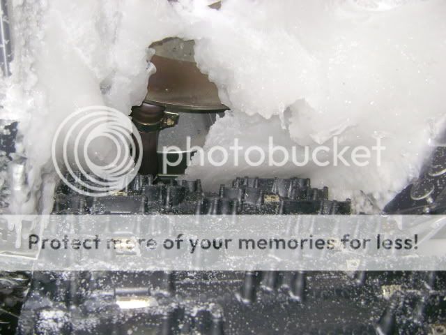

I rode on a zero degree day and I had to stop at 119 mile to chisel out
as much ice as I could.I couldn't reach all the ice up toward the front.This picture is after deicing and about 60 more miles.There is more ice in the rear of the tunnel that is not in the pic.
What causes this???? Is it the exhaust that heats up the tunnel just enough to melt and stick the ice to it? Or is it the lack of tunnel heat exchangers? My buddies Apex doesn't seem to have an issue.
