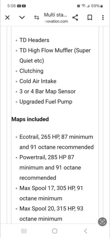

Are you running a header tune with stock exhaust manifold? If so, you are hitting the boost cut. Powertrail at 285hp is a header tune.
