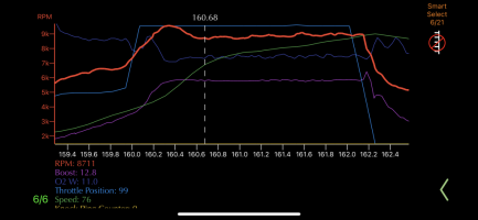

External gate fixed all of the boost spike issues. Seems like this kit should come with an external gate considering the $$ this kit costs. Why does it have a “minimum 26psi” that you have to run? Cause the internal gate is insufficient?

This was just wastegate pressure. Tomorow we will hook up the 2 port solinoid and try for 17psi. This should help allieveate the rpm drop after initial shift out.Any logs u can share and pics of your final install ?

The nipple on the turbo outlet was connected directly to the wastegate for this run, bypassing the stock ecu solinoid valveWaste gate pressure or valve % ?
Do you have the stage 6 cams and large turbo also?

I'm not running the Stage 6 cams either. I was curious about adding an external gate myself.....send another log of a wide open run if you can....this is good info!!

I will get another log. Currently chasing another issue where the 4 bar map sensor is reading a higher boost than what the gauge is showing. (15 gauge shows 30 on the log which then appears to activate boost cut ). Tune is for a 4 bar map.
Once I get the map sensor issue figured out I will post a log
