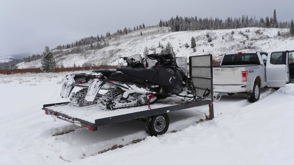

Got another hundred miles on over Turkey days. Was riding with my brother and we had up to 10 inches new to push on a jeep road. So I saw my first real speed on it up about 80mph or so. Needless to say the stock intercoolers were plugged with snow. I have the Hurricane intercooler that replaces the stock airbox. My intake temps were up to 40degrees cooler. So I can say it works as advertised. My brothers LX longer track and higher lugs had more traction but I think ounce we get on a fresh groomed trail I am going to like the handling. My sled threw a SD 85 code and I cleaned the connection to no effect. At the end of the next day it went away on it own. I hope it was a one time deal! Pulled the stock skies and put bigger ones on the second day. Huge difference.
AAdavis
- Sep 30, 2019
- 110
- Age
- 71
- Jackson Wy
- 2020 Yamaha Sidewinder SRX
Forget to add we put my nephew on both turbo sleds and he said for the first time he felt no need for more power!Got another hundred miles on over Turkey days. Was riding with my brother and we had up to 10 inches new to push on a jeep road. So I saw my first real speed on it up about 80mph or so. Needless to say the stock intercoolers were plugged with snow. I have the Hurricane intercooler that replaces the stock airbox. My intake temps were up to 40degrees cooler. So I can say it works as advertised. My brothers LX longer track and higher lugs had more traction but I think ounce we get on a fresh groomed trail I am going to like the handling. My sled threw a SD 85 code and I cleaned the connection to no effect. At the end of the next day it went away on it own. I hope it was a one time deal! Pulled the stock skies and put bigger ones on the second day. Huge difference.View attachment 150936

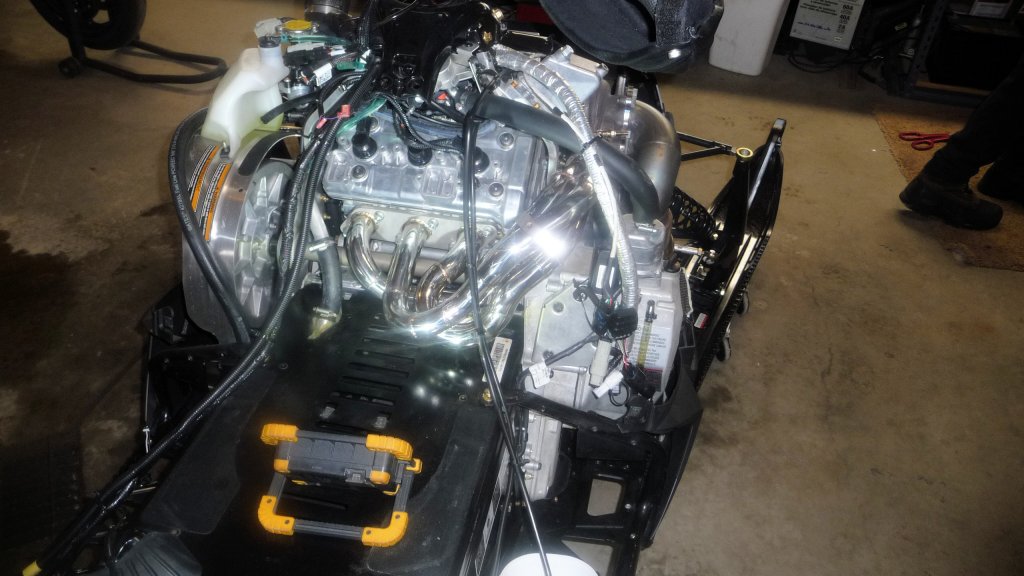

Now that I have had a good taste of the power went ahead and ordered the header, flasher, ect to finish the package!
AAdavis
- Sep 30, 2019
- 110
- Age
- 71
- Jackson Wy
I think the quest for more power will stop here. I am looking forward the SS tune and better response! Corner exit speed!
