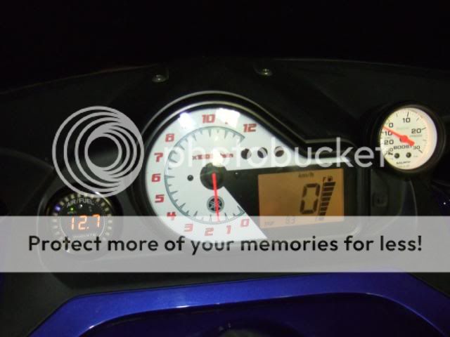

rxrider said:My idle AFR is a bit low, like in the 12s at idle on a warm engine.
I have 22.5 pilots in and pilot screws at 2 turns out. How much should I turn the pilots in to get the AFRs closer?

I will go out tomorrow and adjust my pilot screws in a 1/2 turn. I'm now at 2 turns from seated, will go to 1.5 and see if I can get warm idle AFRs up from 12s to 14s.
Before going to 22.5 pilots AFRs was at 14.7-15.5 idle and 14.5 slow cruising. Throttle response down low was nothing to speak of, much better now with the 22.5 pilots even if it is too rich at 2 turns out.

I adjusted the pilot screws from 2 turns to 1.5 turns out, that did not do anything at all. Idle on a warm engine was still in the low 12s with outside temps at -8C or 17F. I even got into the high 11s after running my sled up and down my driveway.
I will go out tomorrow morning and change out the 22.5 pilots for the stock ones 17.5 pilots, will also go with 2.25 turns out on the pilot screws. I guess this will work just fine, last year the pilot circuitry were just a tad too lean, idle at 14.7 and dropping to 15.5 if left at idle for a minute or so. A 1/4 turn out on the pilot screws may be enough.

I trailered to the mountains this evening to ride my turbo for a few miles up the mountain to test my carb setup. Temps were -6C or 21F.
And the verdict is: 22.5 pilots jets DO NOT work in my sled. Period. They are so history.
At 1 turn out on the pilot screws, warm engine idle was 13.8-14.3, not bad at all. Steady throttle holding it at 4000 rpms, just below engagement, AFR was 13.5, perfect. Taking off driving around slowly on the lake AFRs was in the 12s, slowly giving it more throttle AFRs dropped into the high 11s with no boost. WOT AFR was in the low 10s.
What is happening? It seems to me adjusting down the pilot screws only affects idle to engagement rpms, which were acceptable. Riding it, it went way fat, not running clean at all. After giving it WOT to 16 lbs and let off abruptly, it would stall and die, I had to throttle it to keep it alive with AFRs at 10 or worse. If I understand the pilot circuitry correct, the pilot jets will feed fuel at all throttle positions, the whole range. It has to be that way, it was not that fat last season.
When home I took off the carbs and reinstalled the stock 17.5 pilot jets. I set the pilot screws at 2.25 turns out to give it a little more fuel down low. Last year running the 17.5 pilots jets and pilots screws 2 turns out I had a lean condition off idle, it would stumble and then recover from lack of fuel. I hope I get it right this time
I also removed the carb shut off valve. It did not do any good. Sled started to run funny going richer and richer on the WBO2 until carbs froze up, happened after 2 miles of rinding. Opening the valve fully the AFRs got back to normal in less than a minute. I don't mind holding the throttle open slightly when cranking it, but I do mind having the carbs freeze up and stall the sled from running pig rich killing plugs.

Stock carb springs, haha, you bet. Holtzmans springs DO NOT work in my sled either, now I have the stock springs in there lowered to the #2 position.
Current Jetting:
Main jets = 135
Pilot jets = 17.5
Pilot screws = 2.25 turns out
Needles = #2 position (lowered 1 position)
Stock carb springs
STM Billet Carb Caps
Will have to ride it to verify
I hope I'm close now, but my best guess is that I end up completely stock on the carb settings. If so that would be the first time I have run it with the stock carb settings. I wish I had listened to Erik at MCXpress, he said it was not necessary to rejet the carbs running his turbo kit.
