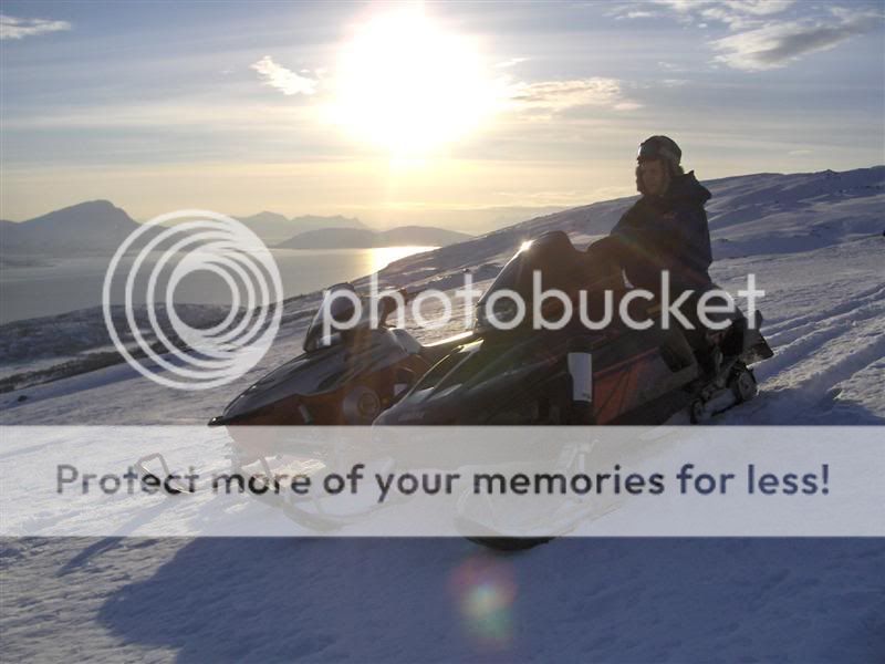

Here are a few pics from today.
Warrior and my friend with the V-Max 4
